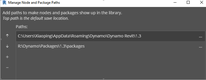

Can you assist with this? Ill do my best to explain. Simply I’m struggling to link paths of an application extra files (things that are constantly updated I need to manage from one place) to the server so I can manage everyone from one folder. However, I think .dll files are struggling to read with the program on the server. Permissions are read/write for everyone. Not sure if it’s the program or something you can help with. The files will work when there in the local path but not the added server path. Previously packages had separate files that worked linking with the server but now the files are stored in the .dll file I think.

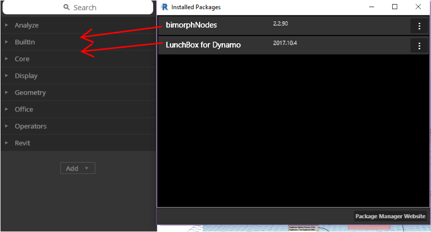

The application will show the packages as installed but not in the library side bar of the application. If it’s a package not using the dll files it will show up however.
Remove all of the packages form the C drive location - it may be loading differing versions which causes some issues. Also, is the R drive a standard windows network drive or is there any kind of cloud mirroring solution going on (the cloud mirroring can break a lot of stuff).
We kind of failed with the same practice. If you google it up there is already a few topic about the same. It’s just not working as it should. Also we made IT to deploy dynamo settings to everyone but the default path kept added back automatically.
One other way is to have a Group Policy to copy all files from the given folder to users default path. Packages are small so it is not drawing a huge network traffic in general.
If we create any dynamo tool that could be extensively used by anyone we take the python script out from the custom nodes and paste it into the script. This way they don’t need all kind of package. archilab and the 1-2 other dll based package getting deployed.
