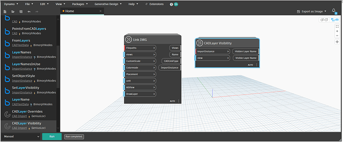

Hi, finally got a few minutes to get back to testing. I already had bimorphNodes package installed so I found the Genius Loci package. In that I see two possibilities: Link DWG and DACLayer Visibility. However, as a total newbie I have no clue how to shoehorn them into a DYN that I found here, which works great on Imported CAD but not for Linked in CAD. See attached images, if you can point me in the right direction that will be very helpful. Thanks, Alan
