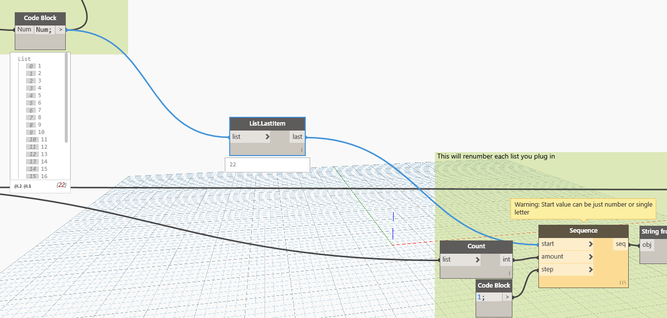

How can I get the Last item in a list (which is a number) to work for the input of a sequence node.
Thanks for any help.
Can you wire an object.type node into the result of the list.last node and confirm that it isn’t a string?
The Object.Type node returns “System.String”.
I got it. I found a sting to number node. Thanks.
