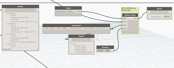

Ok so to implement your response:
  • I double checked that all parameters in the schedule are Text type
  • The number of fields in schedule already match the input fields of the node
  • I converted all of the inputs with the built in node String from Object
I am still having the issue that I have to Insert Data Rows before hitting Run or it only reads the number of Data Rows I have created :frowning: Please check screenshots, I hope I am explaining clearly

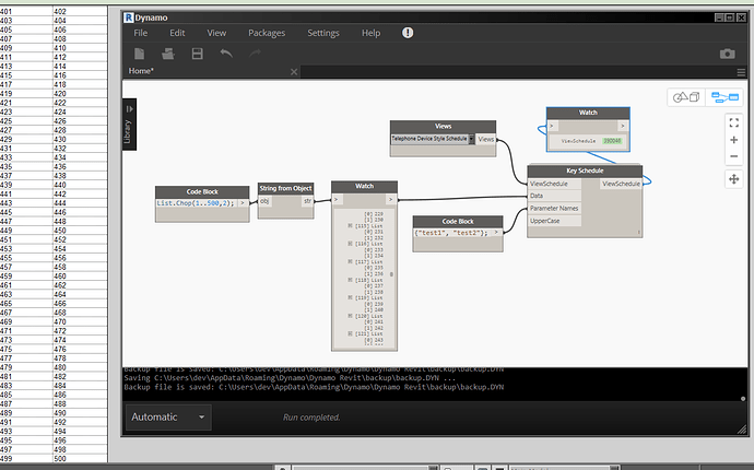

I just tried writing a few hundred entries and it worked just fine. Are you using the latest version of archi-lab?
Ok, so I just deleted and re-opened the node. It worked this time, whatever the issue was!
Thankyyyooouuu :smile:
