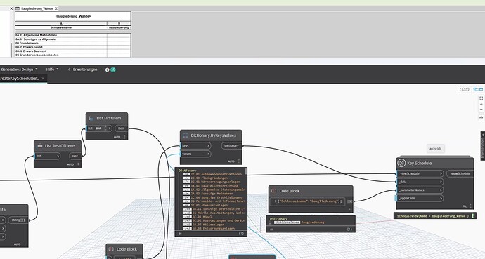

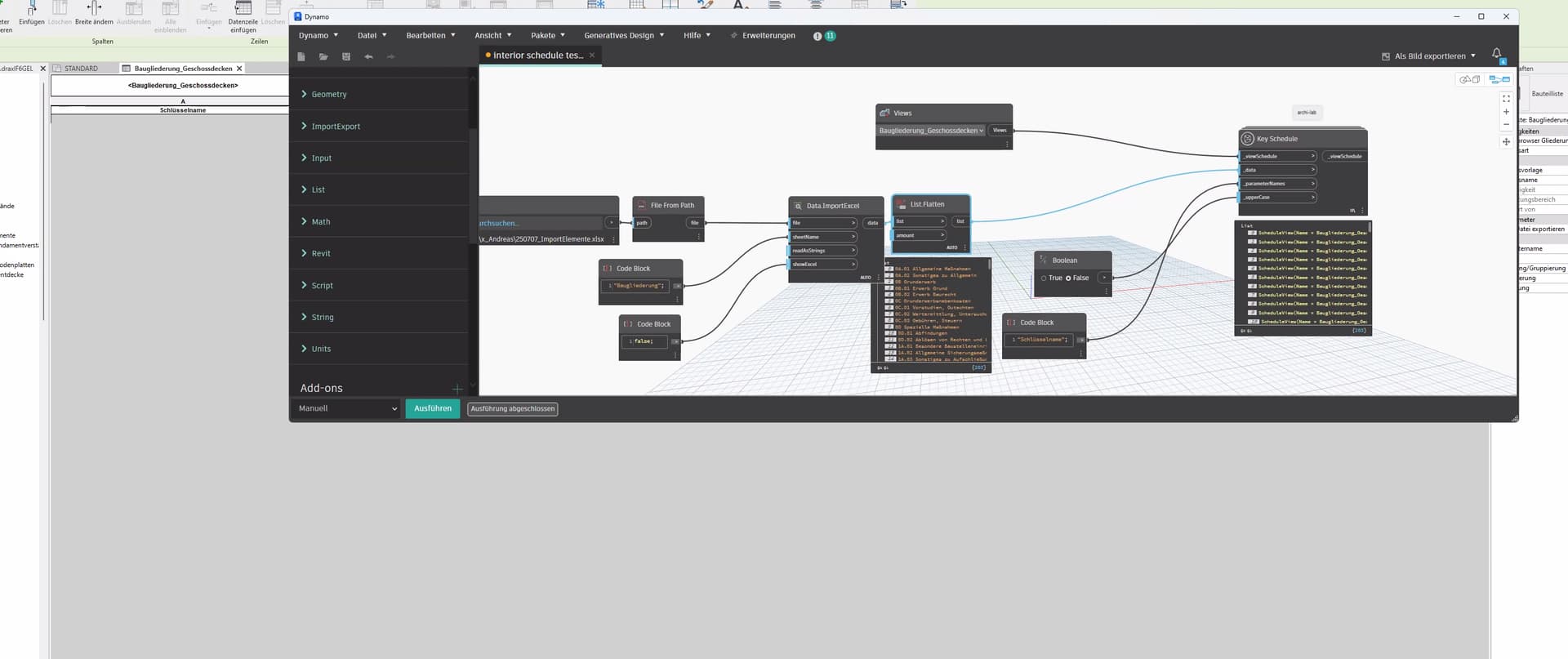

i stuck somehow, i want just to create my keys based on a excel. i get the values, i get the transaction, but nothing happend, there are 200 key values. it even loads, BUT remains empty.
Correct. You’ll need to have all the appropriate fields added before you write to them. You should be able to add fields to a key schedule just like any other schedule. What issue are you running into there?

Latest version isn’t right. You need the newest version that ends in your Revit release to have the right version of archi-lab. Carefully read the link which I posted a few times now but that should be an archi-lab version that reads something like XXXX.YYY.ZZ23.

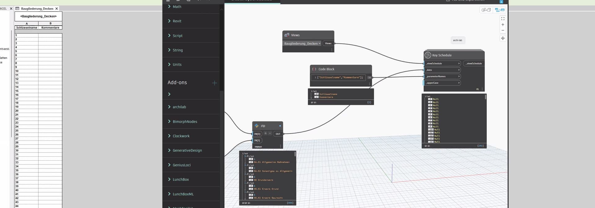

i installed a older version. i filled the keys manualy, but i have still problems filling the “regual” parameter. The posts are older(links, revit 2022) so syntex changed. what have i take in mind, lacing? list-depth ? i stuck somehow.
Unless the input structure is different in older versions, the node isn’t setup for dictionaries. It uses plain lists like your previous post: a list of parameter names and a list of data rows (matching the parameter list).
