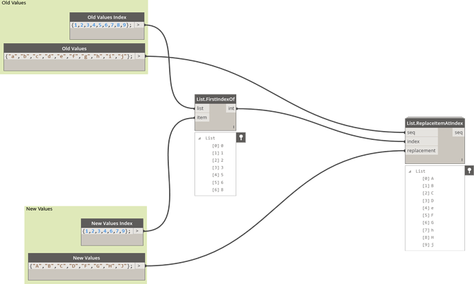

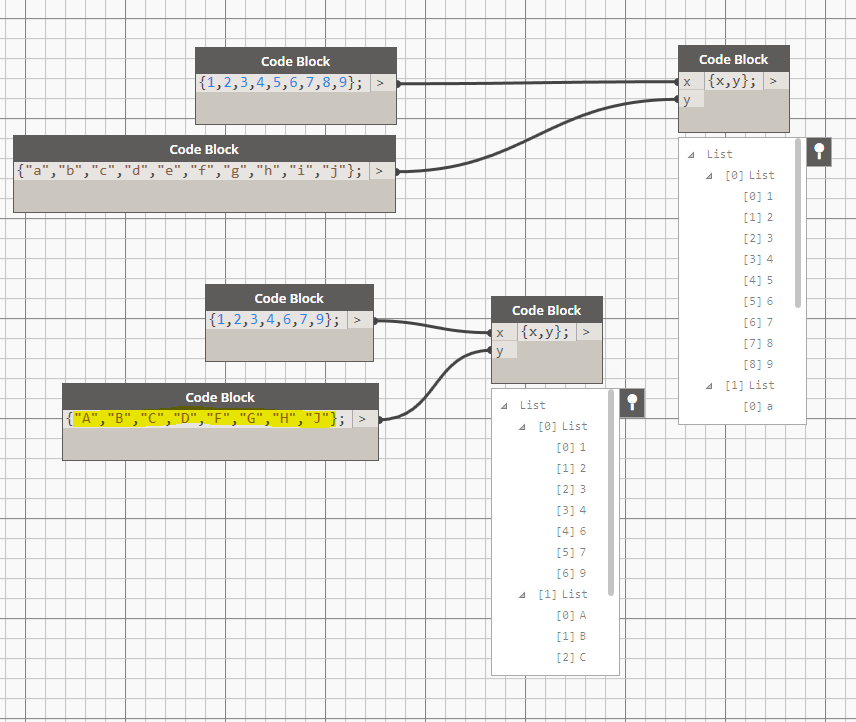

I have two lists of parameter sets. First list says 1=a, 2=b etc. Second list says 1=A, 2=B… second list misses some elements, F and I
So two lists of different lenght. How do i replace all the instances of small letters with the correct capitals (a changes to A, etc…). I want to make sure, that when i insert the value F, it is NOT put into E’s place.

I have several tools in which i do something very similar to what you describe, and the UniqueID is the best way to tie things together.

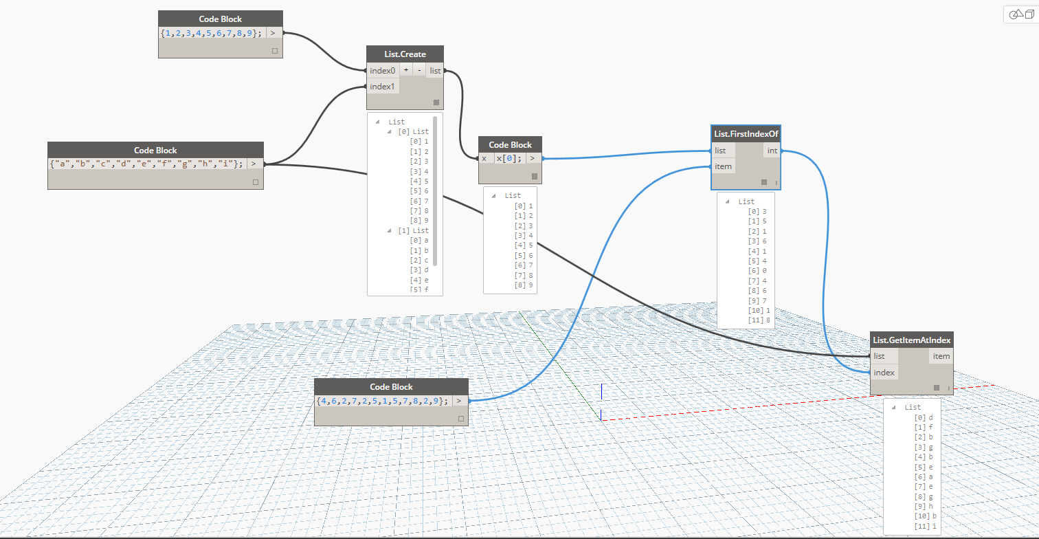

Below is an image that should provide you a solution to your simplified problem of matching up the data. Use the “FirstIndexOf” node to find the matches between two lists (the Excel list of UniqueIDs and the UniqueIDs of the elements in your current model). This will give you the index then of the value you want to write to your model that exists in the second list coming from excel. Use a GetItemAtIndex node to pull the values you want. For your simplified problem you would use a List.ReplaceItemAtIndex node, but for your specific Revit workflow you will likely use an Element.SetParameterValueByName node. Also remember you can look up elements by UniqueID (there are nodes for this in Archilab and Clockwork packages best I recall). Hope this helps.
