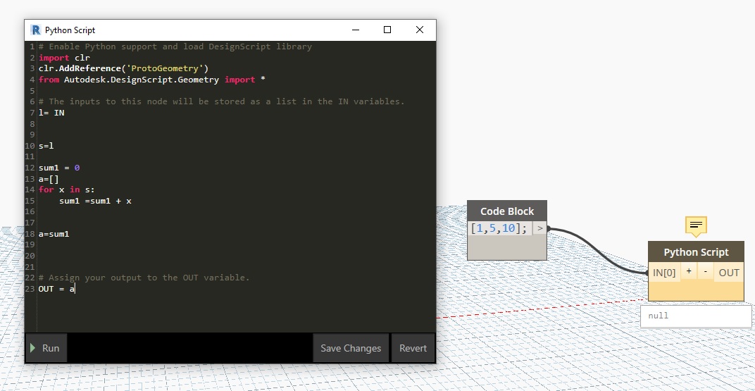

I am trying to iterate through the a list, and this list can have any number of items. In my example, as you can see below i tried to iterate through the list with no luck and i am getting the error of
IronPythonEvaluator.EvaluateIronPythonScript operation failed.
File “”, line 15, in
TypeError: unsupported operand type(s) for +: ‘int’ and ‘list’"
the code I used to iterate inside pythonscript is:
Enable Python support and load DesignScript library
clr.AddReference(‘ProtoGeometry’)
The inputs to this node will be stored as a list in the IN variables.
l= IN
s=l
sum1 = 0
a=
for x in s:
sum1 =sum1 + x
a=sum1
Assign your output to the OUT variable.
OUT = a
Any ideas on how to solve this ?
Many thanks in advance

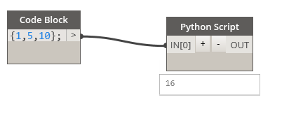

Hi @saeedy3,
The input isn’t correctly defined. You must write IN[0] and not IN :
l = IN[0]
sum1 = 0
for x in l:
	sum1 =sum1 + x
OUT=sum1
sum
I missed my lunch, no energy to idenitfy the mistake :sweat_smile:
Many thanks @Alban_de_Chasteigner you are a legend :slight_smile:

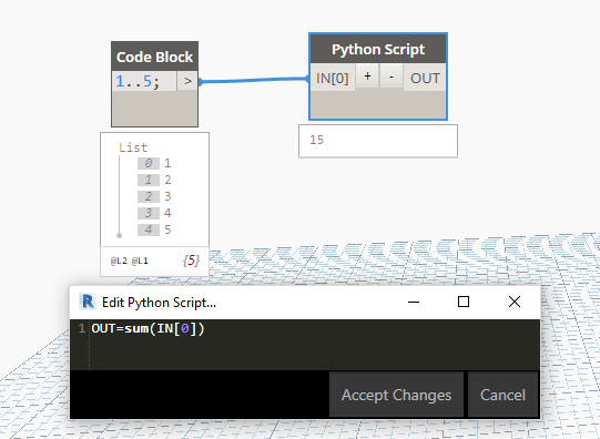

@saeedy3 or you could also use the builtin function sum() :slight_smile:
Brilliant answer. Thank you @salvatoredragotta
