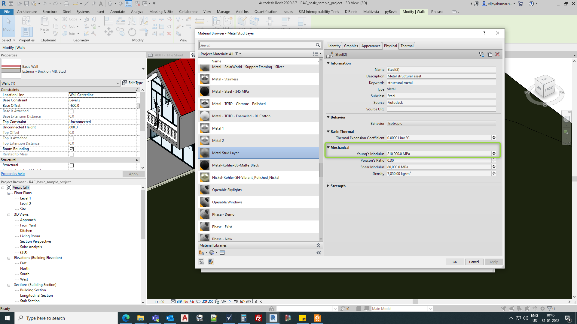

So you need this value right?
Actually, I need the density value. but yeah in general I need info from physical and thermal properties…
#Orchid package all the nodes you need
Did you get what you needed?
Yes! This is what I need. Sorry for the late reply, I got a bit of trouble with Orchid installation. Now it works flawlessly. Hopefully, the info won’t change just like the prev problem. Thank you for the input, Vijay. Have a good day!
