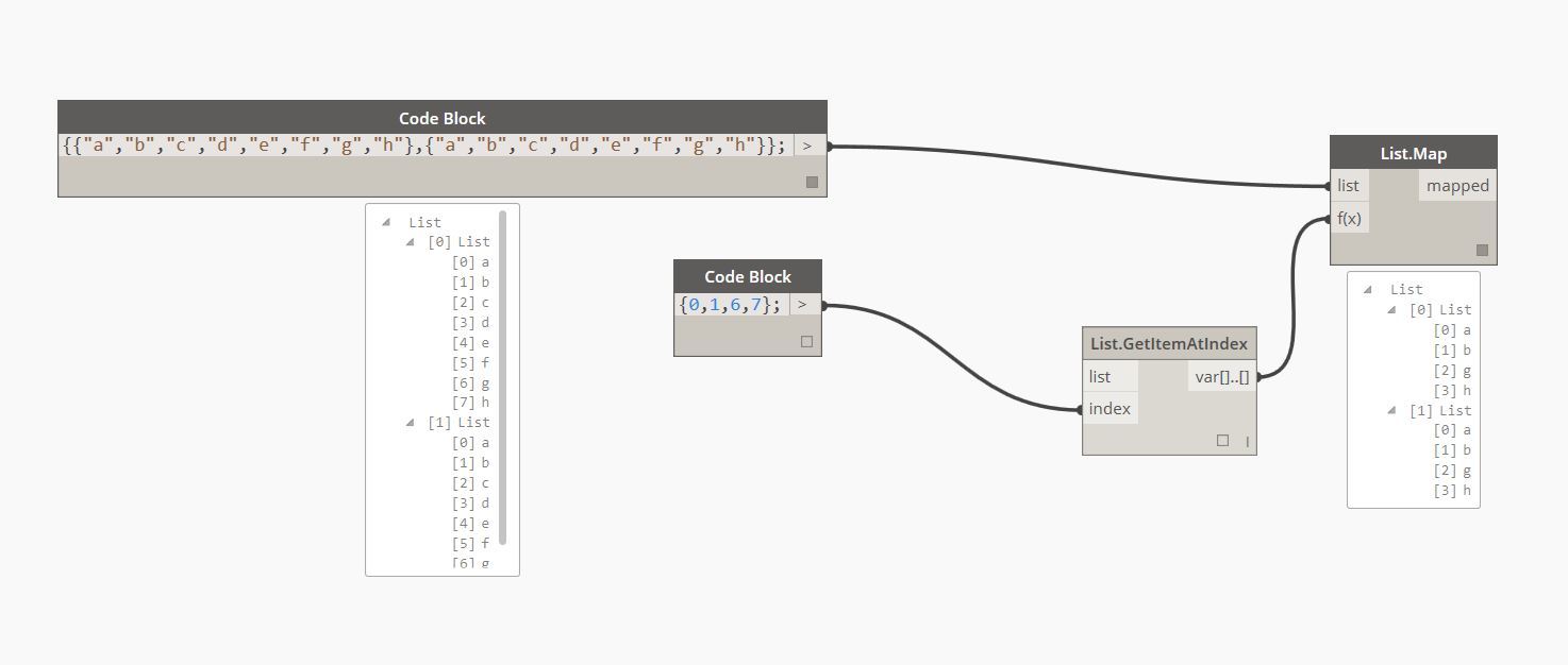

I am trying to understand the TakeEveryNthem but without success. My aim is to place a adaptive component with 4 points. My list of point is listed, so that I need point [0+1+6+7] to create the component I wish for.
When I use TakeEveryNthem with the offset of 1 and N of 2 I get point number 0+2+4+6 and so on.
When I use TakeEveryNthem with the offset of 2 and N of 2 I get point number 1+3+5+7 and so on.
When I use TakeEveryNthem with the offset of 7 and N of 2 I get point number 0+2+4+6 and so on.
When I use TakeEveryNthem with the offset of 8 and N of 2 I get point number 1+3+5+7 and so on.
What am I doing wrong here?
