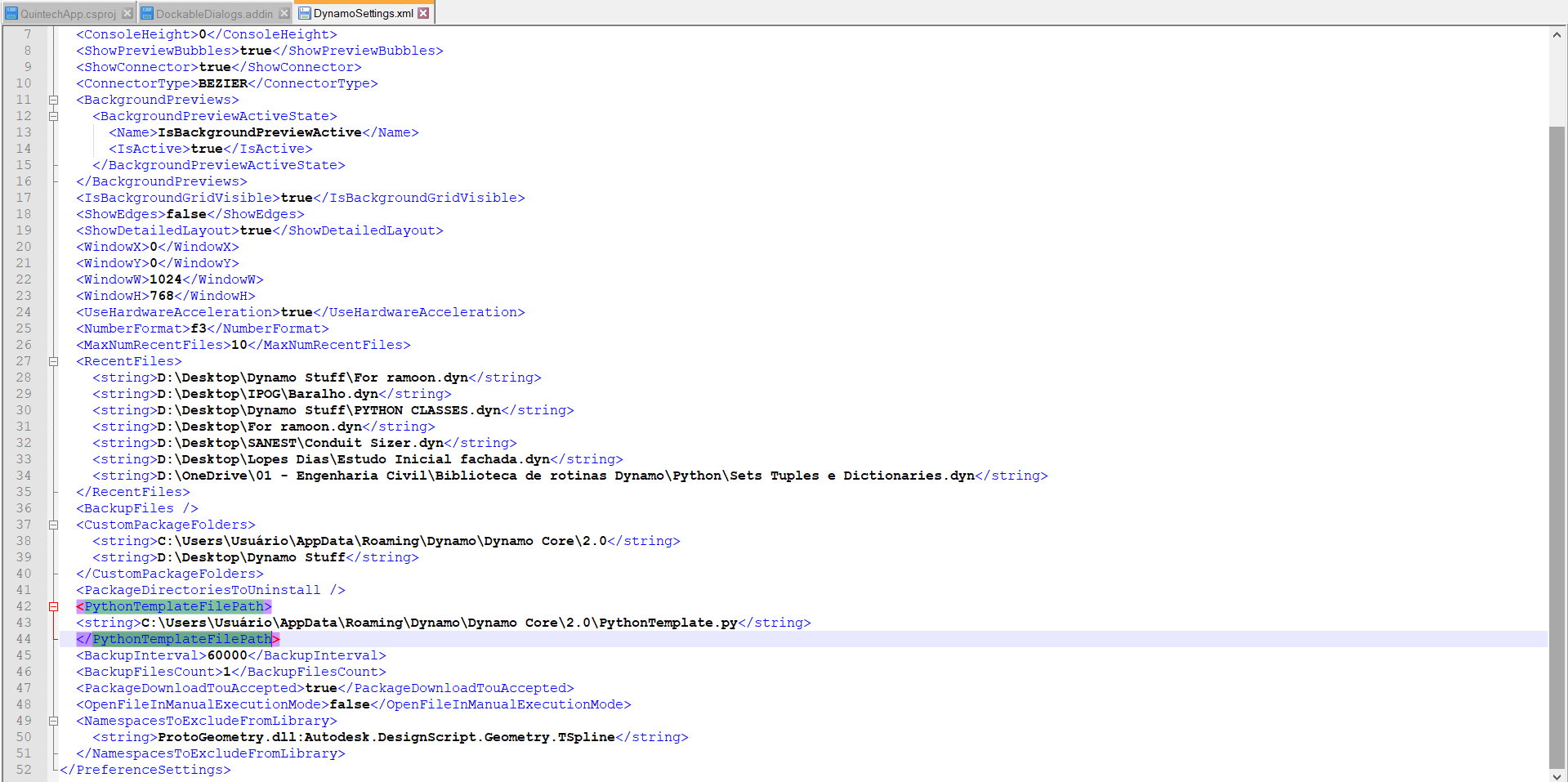

And this is my DynamoSettings.xml File
These are the exact same steps explicited in the tutorial… but it didn’t work for me.

Hi @ramoon.bandeira
Try removing from start and end and also continue on the same line <PythonTemplateFilePath>C:\Users\Appdata\Roaming\Dynamo....
Tryed that. Unfortunately it didn’t work.
Try :
<PythonTemplateFilePath>C:\Users\chuong.ho\AppData\Roaming\Dynamo\Dynamo Revit\2.1\PythonTemplate.py</PythonTemplateFilePath>
Or :
<CustomPackageFolders>
    <string>Z:\DYNAMO\PythonTemplate.py</string>
    <string>C:\Users\mka\AppData\Roaming\Dynamo\Dynamo Revit\2.0</string>
  </CustomPackageFolders>
  <PackageDirectoriesToUninstall />
  <PythonTemplateFilePath>Z:\DYNAMO\PythonTemplate.py</PythonTemplateFilePath>
  <BackupInterval>60000</BackupInterval>
PythonTemplate.py (924 Bytes)
Using your guide and setting those properties to the %appdata%/Dynamo/DynamoRevit/DynamoSettings file, solved my problem.
Thanks a lot!!!
