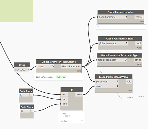

I am hoping to get some help with setting a Yes/No global parameter. I have successfully modified text based global parameters in this script but the Yes/No is being a pain. Here is the method I am using right now.
As you can see it is not setting the value to Yes.
Any thoughts??

Maybe this is due to the structure of the output of your If statement ? You are setting the value of the Global Parameter to a list containing 1 (aka [1] ), not to the actual value.

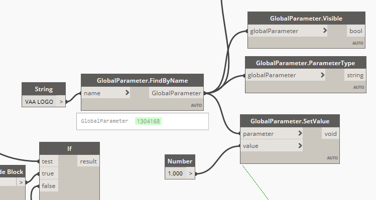

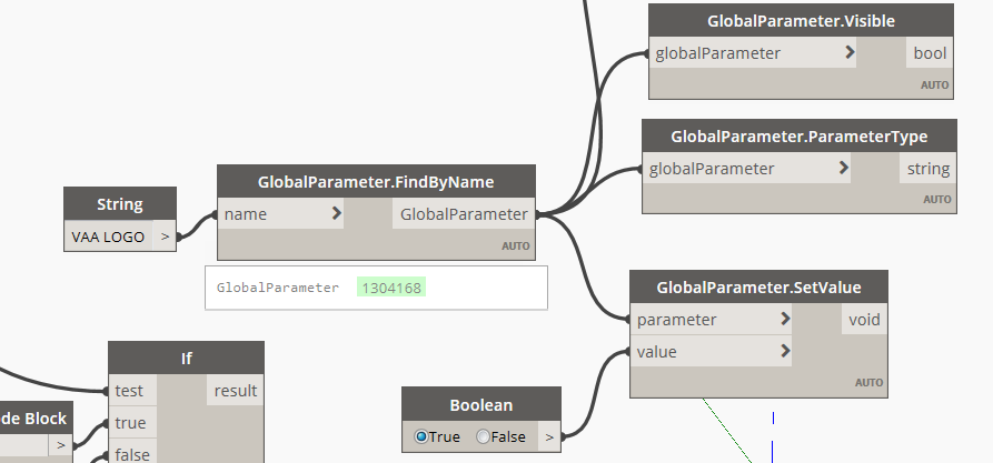

@mellouze Here are two attempts at making sure the list is not the problem.
Both results in the same outcome.
@lucamanzoni I did try true/false but that was last friday so I will try it again just to make sure.
Same result. :frowning:
