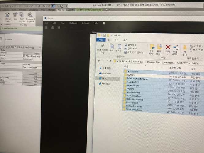

Isnt showing at nodes,
I already read this link
upload my photo, plz teach me what to do !
Update your Revit to the latest.
Try moving your add ins from your Revit add ins folder.
This is just my understanding of what I read from your link
@vanman is correct - you need to first update Revit and then remove all addins. A screenshot of your dynamo console log may help.
