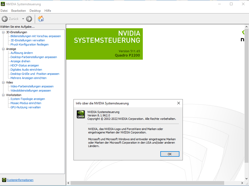

Let complete setup cuda, install drive ndivia,cudnn to support first , next check again and use it in dynamo core, can show me info card vga in your computer ?

now my problem it still tensorflow not work with Gpu
