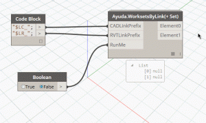

Here’s the node that I now have for you, available in Ayuda. (Get it in the package manager)
2015-10-01_09h42_34
Here is is in action (the null value is for if you have a CAD file linked directly on a sheet view, this workset is not editable at all)
WorksetByLink
And here are the custom nodes “innards”.
2015-10-01_09h44_05
