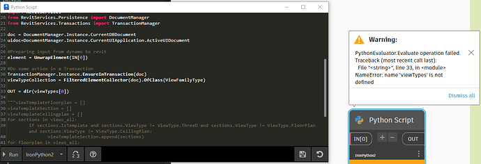

In some cases I get an error and cant understand why.
viewTypeCollection = FilteredElementCollector(doc).OfClass(ViewFamilyType) for i in viewTypeCollection: if i.ViewFamily == ViewFamily.ThreeDimensional: viewType = i else: continue
I get an error here when changing to Cpython
ERROR MESSAGE: ViewFamilyType has no attribute ViewFamily

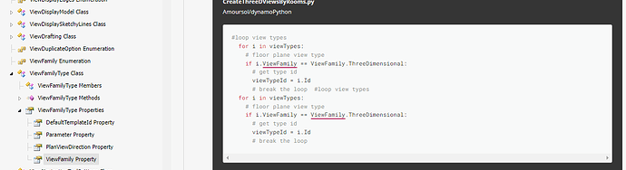

When I look in the API my code seems right, what am I missing here?
I recommend you check to see what options you have available to you on the viewTypes objects.
  1. Comment out the for loop and anything that relies upon it by adding a triple quotation mark before it, and after the last line of code.
  2. Before the new triple quoted string add the line OUT = dir(viewTypes[0]), which will pull the directory of what you can do to a view type. If you see ViewFamily as an option, pull it’s documentation by changing the line to OUT = viewTypes[0].ViewFamily.__documentation__ and see if that gives you any indication of what added override requirements may be. You can also check to see if there is a method called something like get_ViewFamily, which would be the CPython converted method to call the results of the ViewFamily property.
I would also check what the Filtered Element Collector is returning as the only difference when getting the ViewFamily attribute between IronPython and CPython is that IP returns a Type and CP returns an integer

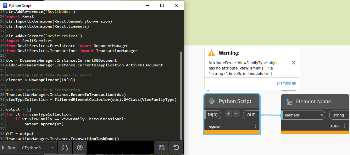

This code works for me in both versions of python
output = []
for vt in viewTypeCollection:
    if vt.ViewFamily == ViewFamily.ThreeDimensional:
        output.append(vt)
OUT = output
Your code could be cleaner else: continue is implied in the if statement so is unnecessary.
You overwrite viewType so, if there are multiple types, you will get the last one.
Sol’s original code has a break so it selects the first available 3D view type before further processing

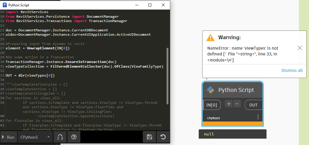

Hi Jacob,
Thanks for your replies, this is what I get

I’ve tried your code and this is what I get.
Your first triple wuotestion mark is in the wrong spot. It should be at the start of the line after the first comment at the top of the original screenshot.
Reading information from the document does not have to be inside a Transaction - only when you edit the document (move, add, delete, modify, etc.)
Are you able to post your whole code and what version of Revit / dynamo you are using?
It’s strange, for several users it seems that PythonNet cannot access certain properties

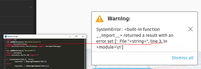

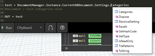

Finding it a pain to convert from Ironpython 2 to Cpython, I think I get strange error messages that I don’t know how to deal with, take the example below that I got this morning.
I have previously developed in VB.NET and never experienced this issue between .NET versions that I experience with Python.
systemerror: RevitServices
When I change to Ironpython 2 everything works as expected
Hey! @BIM_Mrbrango
This is caused precisely by the fact that the Cpython3 packages are not loaded from Dynamo startup. The way to solve this is to force the python graph to run.

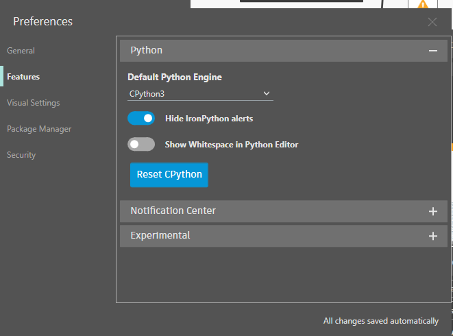

Do you mean setting preference to CPython3 as default engine to force the python graph to run?

Alternatively, you can use IronPython3 (available via package manager) of all the python engines available to date in DynamoBIM, to date in my opinion Ipy3 is the best implementation/compatibility with Net FrameWork AND especially NetCore with future versions of DynamoBIM (maybe it can change with PythonNet 3 in future).
