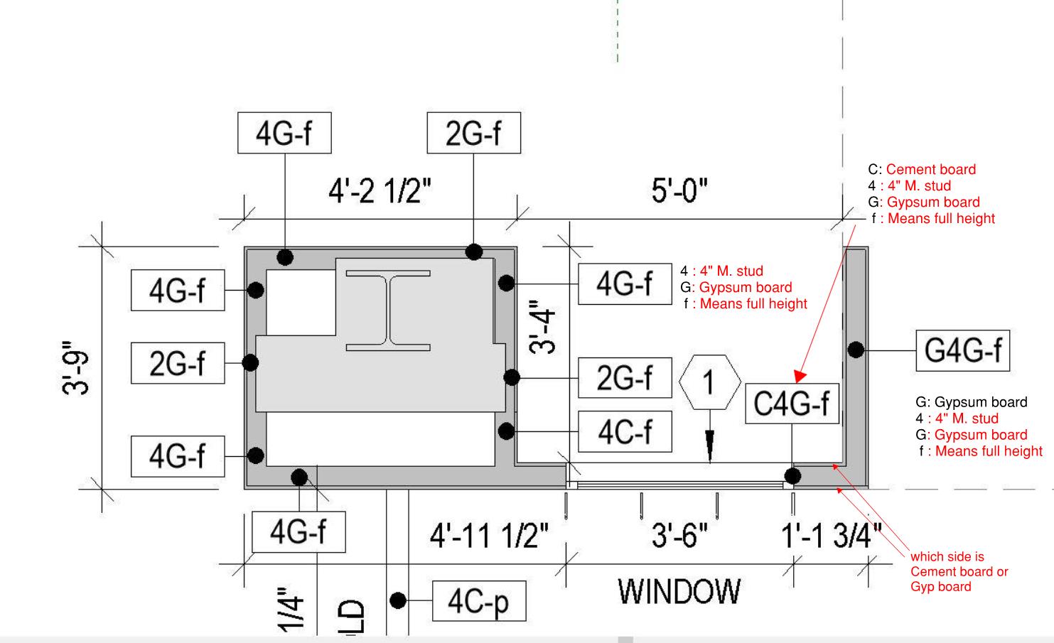

We are working on projects has different wall types by their own design. For example, the interior partition has 4’ cement board + rest of height is gyp on one side another side gyp full height, etc… as you will know and most of the projects have unique wall types.
I do not know if this forum has it somewhere, I searched and read almost every wall related forum topics but couldn’t get a close look. If you know maybe I missed the opened topic please forward me and i will definitely delete this topic not to confuse the others.
Here is my question;
Is there a way to tag these walls per material side, for example; if you look at my attachment, which side is gypboard which side is cement board. In-wall type family, as you know in Revit we have exterior and interior designations , So can I
