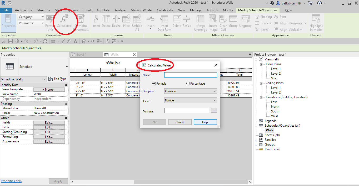

Is there a way in dynamo i can insert a column in revit schedule using the option of “calculated value” ? of course i want to name it of my choice, and also make total of the values in the that column in the last row!

yes that is exactly what i want @Kulkul , but i want this field to be a “calculated value”. means; i want to put a formula in this. like i want this w = paramter1 * parameter2
so it becomes:
