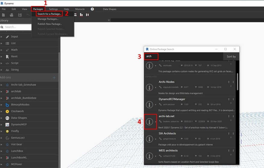

@lauratraum12 Glad that the Python option worked for you.
For option-2, you need to install a package called Clockwork.
To search and install a package
  1. Click on Packages Menu
  2. Choose “Search for a Package…” to browse through available packages
  3. Search the package you want to install (Clockwork for Dynamo 2.x here)
  4. Click the download button to install the Package

So far I have not encountered any issues using the package manager.
And the manual loading is quite tedious for someone who just started with Dynamo. So I usually don’t suggest that!
But in case if the package manager route fails, this should help them install the packages manually.
