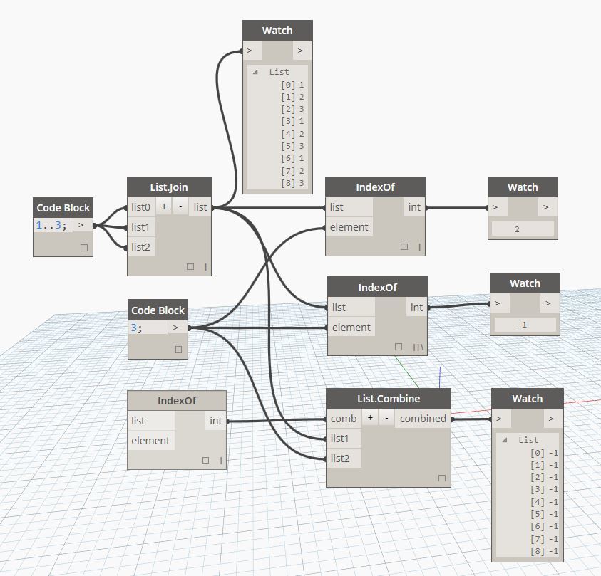

Is there a way to get the index of all occurrences within a list?
Follow up to my first post why does this IndexOf return -1 when the item I am looking for is in the list?
Try the “List.AllIndicesOf” node.
About your second question, that’s just an oversight. Somebody just forgot that “-1” is a valid list index in DS:

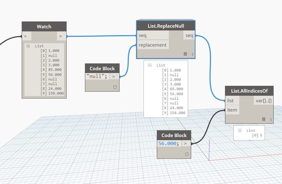

If you use Clockwork’s List.ReplaceNull, to replace all the nulls with “nulls” it will give you what you want. I dont know if this causes you problems further down your graph.
That would work and then I just look for “null”. I was trying to replace the null values with a matching index value from another list. Thats why I needed the index value. I ended up using an if statement and is value null. True use value from list B if false use value from list A.

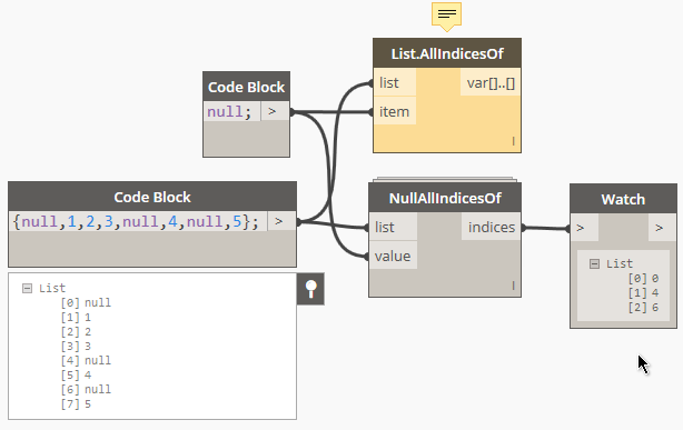

Alternatively, for this particular case, you could try the “NullAllIndicesOf” from spring nodes.
Wow did not know that was in spring nodes. thanks dimitar,
