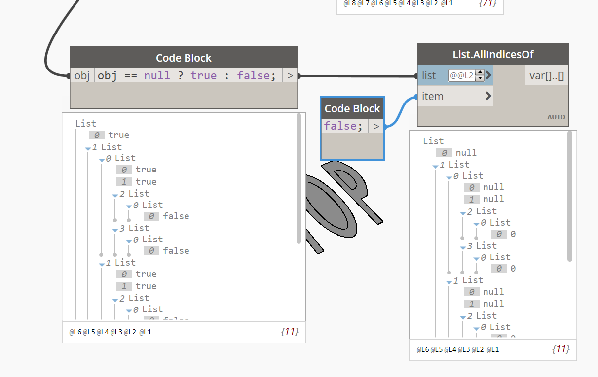

I am trying to get the correct indices to use the node List.Insert.
The problem is that i keep getting null values instead of empty lists / nothing at all, and i can’t get rid of those null values. And because of these null values my list.insert node doesnt work.
I have some questions about what you are trying to do.
Do you really need this overly complicated List structure?
What is the end goal you are trying to do? What is the Next step?
The List.AllIndicesOf will not work on this list structure and will always return Nulls.
