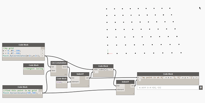

I am pretty sure there is a simple answer to this- I just can’t figure out what it is…!
I need to take the index of a list and use it as an identifier for a grid of points
In the example shown below- I need to extract the index of the highlighted point [5,2] and convert it to a string indicating the column/row. So the 5th column & 2nd row --> X5 Y2
I have tried IndexOf, AllIndicesOf etc with no success
thank you in advance

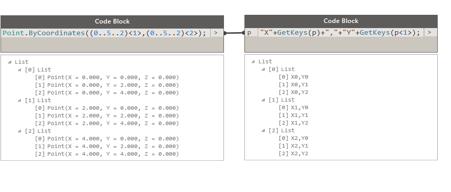

thanks for the very quick reply Dimitar.
I’m not sure if I have explained myself very well- perhaps I mean ‘key’ rather than index.
I would like to generate the XY for each point, not just one of them

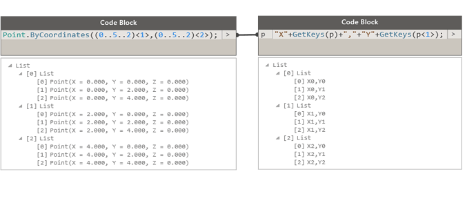

The format of the output can be altered to suit your requirement…
thanks Vikram, that is fantastic- exactly what I needed
Thank you for your help Dimitar

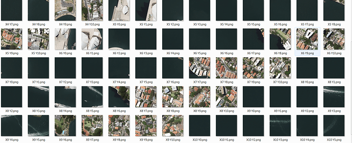

I built this Dynamo graph to generate the image URLs based on a base coordinate, grid size and number of rows/columns, and name the image based on the row/column location.
Refer https://youtu.be/XDbJ_JFnK0s
Each WMS server is a bit different- need to play around with the URL layers, file format etc and also enter the correct EPSG coordinate zone.
I used Pentaho to download the images and name them correctly. Tested up to 100x100 rows & columns- takes several hours to generate/download the images.
It is not super-accurate (speak to a surveyor or GIS person & they will talk about geodetic projections etc) but at least you get images with known real world dimensions & corner coordinates, and these can easily be built into a mosaic.
