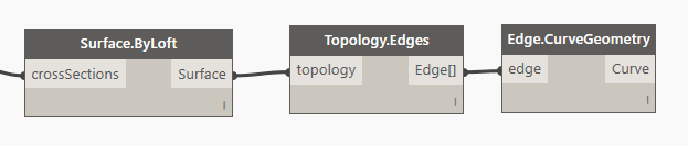

You could extract the edges from the lofted surface.
Would need to eliminate overlapping edges though
@Vikram_Subbaiah Perfect¡¡¡ I will try and i will upload the progress.
