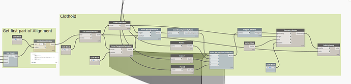

I am creating a sweep from the cross section.
This is how the sweep is created.
I want to be able to apply an angles on all of the point of my nurbscruve.
The nurbscurve is created from a series of point in excel, total of 102 points.
When plotting on the Dynamo it look like this.
I want to be able to make my sweep rotate on each point, can you guys help me out.

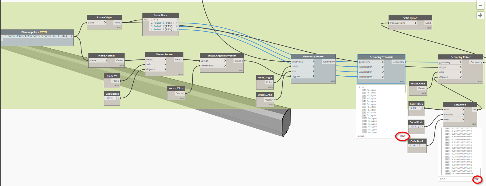

Hi @komchan.prak …how about something…and just try to give the degree from your excel sheet
Can we make a plan that’s on the curve but using the point from the coordinates that we use to create a nurbscurve.
Yes if i understand right :wink:
if it a nurbscurve then make sure the vector is to same side…
Thanks, I almost got it with this.
I have trouble with the geometry rotation I need to use the list of angle 101 if I use 102 I will received a warning on solidbyloft. I will need to apply a total angle of 102 to all the points. Do you know how can I solve this.
