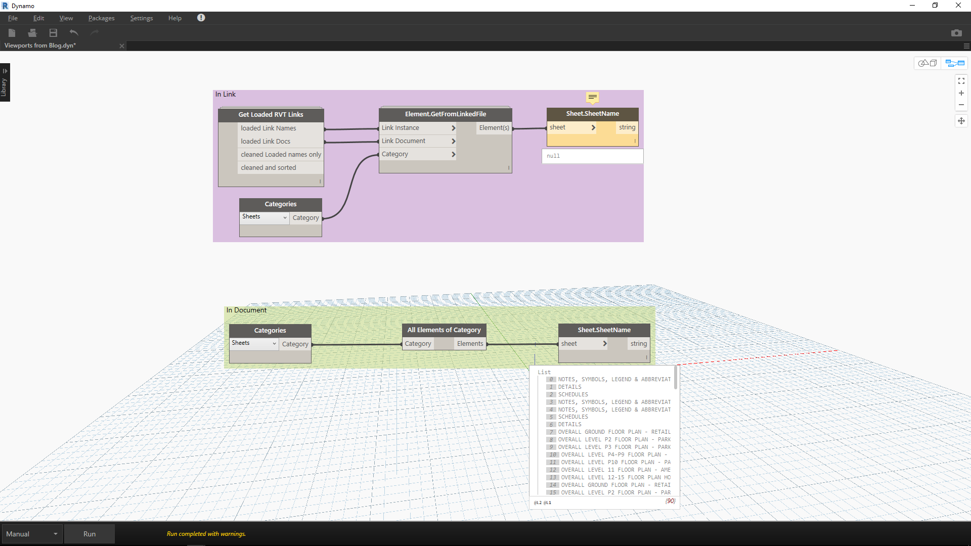

This is probably a beginner hurdle but I can’t seem to find anything on this.
I have a Sheet.SheetName node working in the document but when I try the same node in a link, it fails.
I feel like I’m missing something. Thank you for any tips or directions regarding this.
Can you watch the results of the element.getfromlinkedfile node?
Hi @tlivingston ,
you can get the name of linked sheets using GetParameterValueByName :

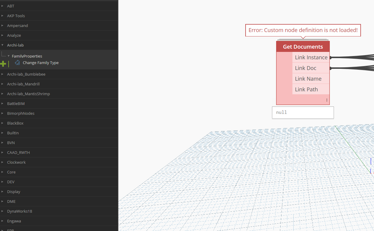

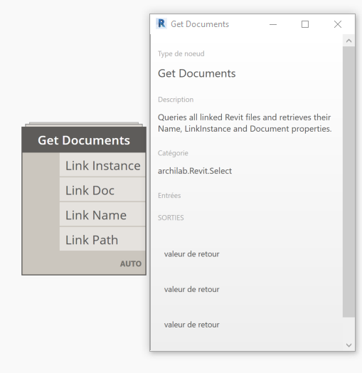

is it still available the get documents node or another one similar (it says the version is rather old)?
would you be able to share the python code that is inside?
Thanks for your reply.
I don’t know what I am missing but I cannot manage to get the node working, apologies for the inconvenience
Archilab package does not appear to be installed on your computer.
Use the package manager to install it.
I am very sorry again but I don’t manage to find it.
would you please mind to share the python script?
Hi @COY
Use lower case letter and type archi-lab
that damn dash gets me every time… ![]()
