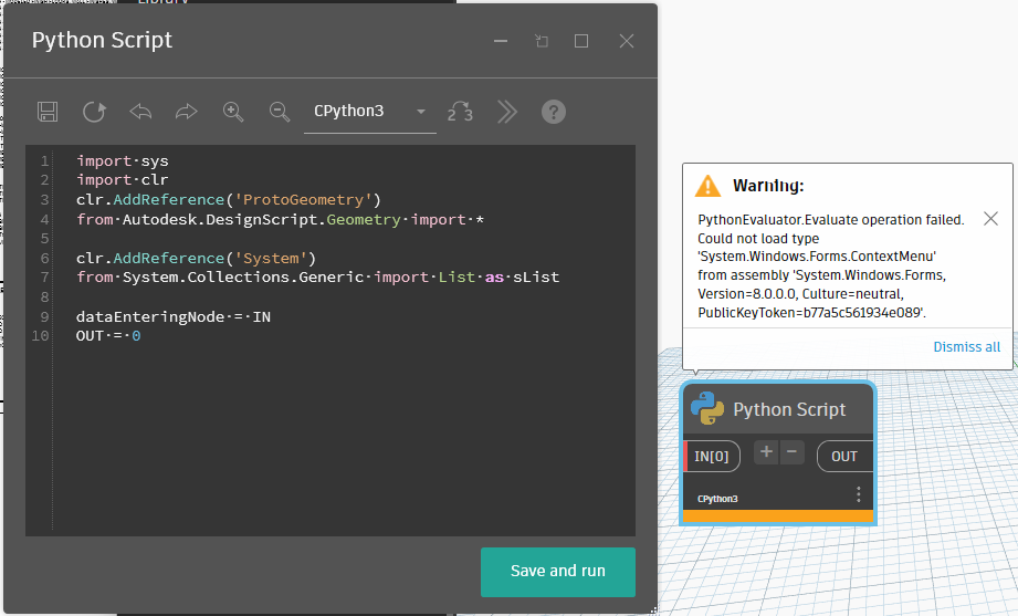

In a python node for Dynamo 3.2 in Revit 2025 if I try adding the following reference, I get a warning related to System.Windows.Forms.Context menu not being loaded. Just to note, I have been using this import in my py template for several years and never had an issue before.
clr.AddReference('System')

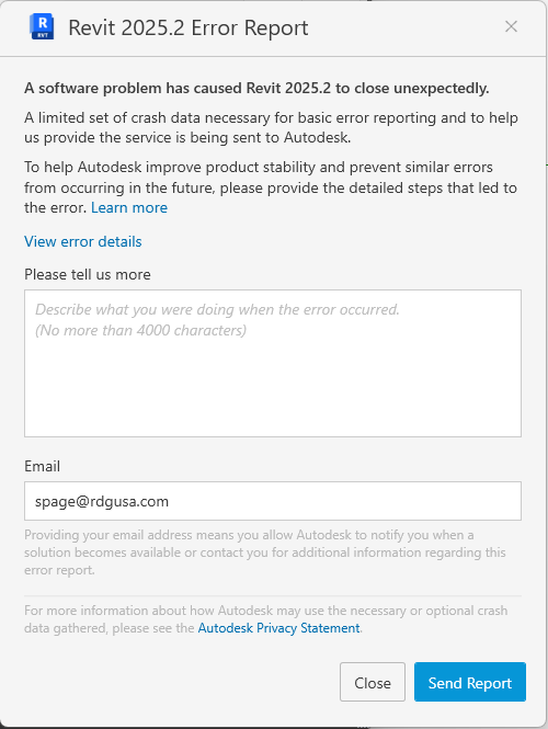

After that then Revit locks up and Crashes.

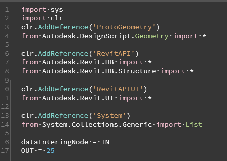

Here is the python node:
This may not be related but something i noticed. It is wise that you make this imported list name different as i show below. This stops the chance of this import causing a conflict with the python List.
#Imports Ilists module into python
clr.AddReference("System")
from System.Collections.Generic import List as cList
