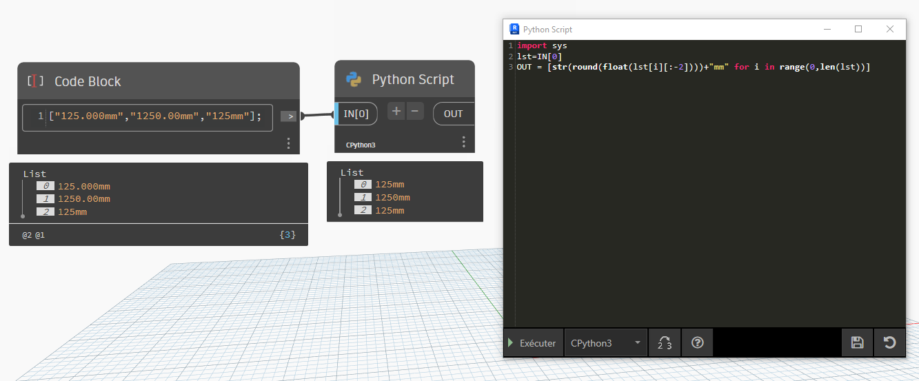

I tried with great difficulty
import sys
lst=IN[0]
OUT = [str(round(float(lst[i][:-2])))+"mm" for i in range(0,len(lst))]
Cordially
christian.stan
