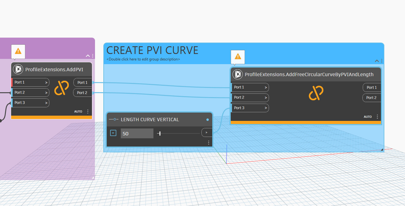

I couldn't find these two nodes in Civil 3D 2026 Dynamo
I couldn’t find these two nodes in Civil 3D 2026 Dynamo. These nodes were very useful…
@mzjensen , @zachri.jensen , @Paolo_Emilio_Serra1
Hi everyone, I haven’t received a response regarding the nodes I sent above. It would be great if it were included in an update or version 2027. Thanks.
They are probably found in the C3DToolkit, which is not maintained anymore (and only available in C3D 2024 and older). Maybe these nodes will be added to the core or other packages in the future.
These nodes perform the same function as the nodes I asked about above.
I find this interesting because I’ve been looking for the same thing. Did you create it yourself or did you get it from a guide?
yes i set it myself
