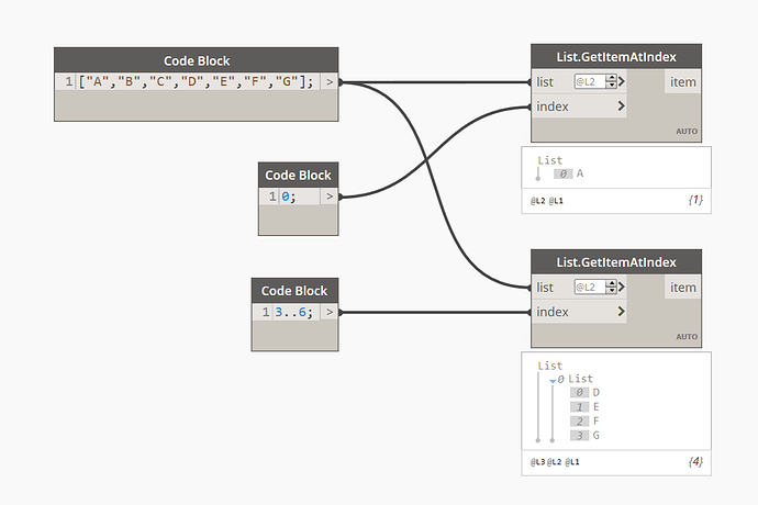

Hello community,
I’m trying to transform the flat list in the picture bellow (which is the output of a MySQL request) into a tree list with 5 levels: building name [index 0] > level name [index 1] > Super family name [index 2] > Group name [index 3] > Rest of each sublist [index 4 to 6].

what do you mean by flat list?
I recommend posting an example of what you’re wanting in the end. It’s a little hard to understand exactly what you’re after, but you might try the List.Chop
node to break your list into sublists.
Of course the first thing you’ll have to do is convert index 5 to an actual list. Right now it’s just a single string with line breaks. You’ll have to use String.Split
to break those lines into individual objects.
Just curious why you need a complex list structure like this? Maybe try a dictionary instead if it’s just for organization…
