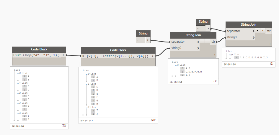

You could use list indexing together with something like the “Flatten” command:
{x[0], Flatten(x[1…3]), x[4]};
Then proceed with a String.Join node (or two) :
An example of your list structure would help clear things up
@Sergio or something like this?
20171026-1

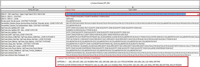

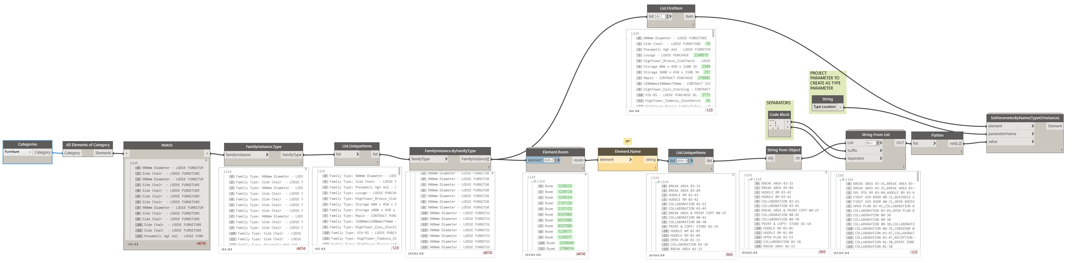

Hello guys,
Thanks for the comments @awilliams @Dimitar_Venkov. Find attached a couple of images to clarify the issue in question.
Looking forwards to your answers.
Regards,
Sergio
And @Vikram_Subbaiah and @Yna_Db, folloowing the schedule that I have with the previous Dynamo script and on the bottom the two possible ways to explain the location of the furniture that I would like to achieve.

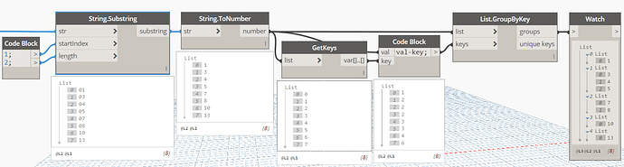

Once you have your levels filtered down to integers you can group consecutive values together. Then you just need to do a little IF magic to get your levels to single values or paired mins and maxes.
Thanks so much @Nick_Boyts, I’ll read more about GetKeys and List.GroupByKey to understand how they work, Also let’s see if I figure out the magic node. But this is a great advance!
