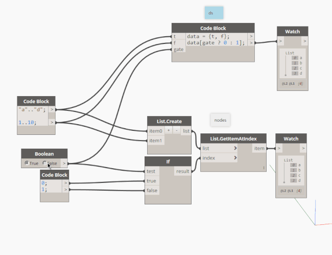

I first saw this workaround from @Andreas_Dieckmann and quite like it:
You build a list of your results and pass an index insteadof the actual results.
I actually turned this into a node: ScopeIf+ in Clockwork.
Maybe this will help to understand the IF statement in dynamo.
What’s the advantage of using that over using an if node the general way?
the designscript method is independant of installed packages
…if I’m honest I still don’t get it.
But it may not be that important, I was just curious
In this case in both examples there are no nodes used from installed packages.
But if it were, you could run the graph with designscript in it on any computer so you can share the graph and it would always work.
