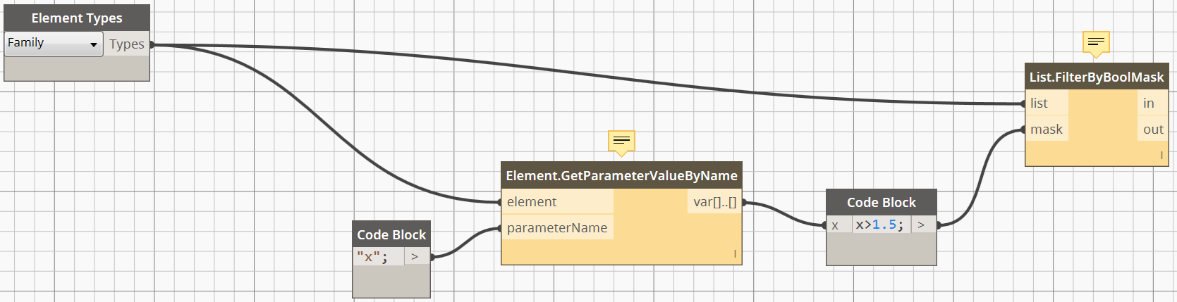

how to select elements that have a length greater than a defined value
in my case i wont to select element with length greater than 1.5

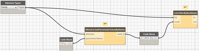

I’m thinking this should work, I used the the
Element Types node instead of the Element.ElementType node (which I don’t have), and my script doesn’t work, but I think this structure should work for you.
It depends on what the parameter of the family is outputting. If the parameter is a string you may need to convert the string (text) to a number in order to use that formula x>1.5.
