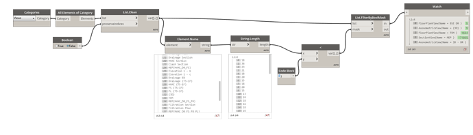

So quick discription, trying to get the list of the floor plans only from an architect file, I’m going to write the information onto an excel file. However as you can see…Arch has way too many floor plans and I only need the main ones, 1st floor, 2nd floor, 3rd, 4th, parking and roof; and down the line the reflected ceiling plans.
So i was struggling to figure out how to further filter out the list to get only the ones i need and figured character length is the way to go, if you guys know anything else thats easier please share…

So the reason the string.length isn’t working is because right now you have a list of elements (not strings). You want the name of those views as the name is a string.
This would be how to compare name lengths (keep in mind that a space counts as a character, so “1st floor” is actually 9 characters):
That whole section could probably be simplified. Would it be easier to compare level names to view names?
