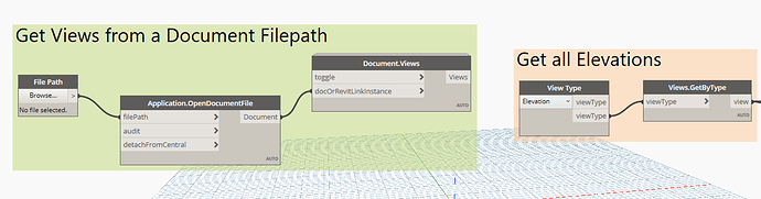

I’m trying to retrieve all the elevations from a RVT document filepath. So far I can get all views but cannot find a node or means to filter it down to elevations the way the regular View Type node would if I had opened the RVT file directly. Thanks for any guidance you can provide.

You can make a filter to collect only the elevations or use python :
#Copyright(c) 2015, Konrad Sobon
# @arch_laboratory, http://archi-lab.net
import RevitServices
# Import RevitAPI
clr.AddReference('RevitAPI')
import Autodesk
# Import ToDSType(bool) extension method
import Revit
def tolist(x):
    if hasattr(x,'__iter__'): return x
    else : return [x]
doc = tolist(IN[0])
#collect all views in the model
for d in doc:
	collector = FilteredElementCollector(d)
views = collector.OfClass(View).ToElements()
#sort views into separate lists based on view type
elevations = []
for i in views:
	if not i.IsTemplate:
		if i.ViewType == ViewType.Elevation:
			elevations.append(i.ToDSType(True))
		else:
			continue
#Assign your output to the OUT variable
OUT = elevations
