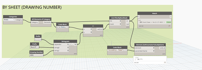

see below my snip.
i get a sheet (Sheet Name:- Revit-ST-0053) as per my requirement but it’s not open in revit. it just shown on dynamo.
my requirement is whatever sheet i choose it’s should be open in revit.
Hi Robert,
Isn’t this something you can do using the search function on the project browser? to me, it seems a long way to go to open a drawing sheet.
Hi Renzoj,
Could you please explain me what are the steps to be taken to open the sheet. and how?
