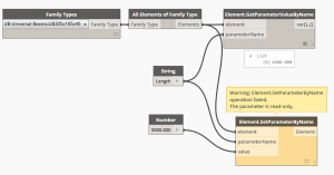

How to modify the length of structural beam? This is my problem now with Dynamo. It´s impossible to modify this parameter.Capture
Unfortunately, this is a read-only parameter and the only way to change the beam length is by applying a new curve through the API.

Is there a node available to lengthen a beam ?
Lengtening the curve line doesn’t affect the beam length.
