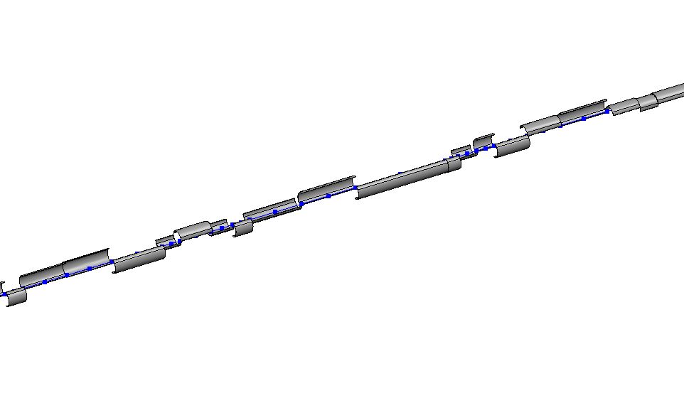

Hi, All.
I once created a topic about the rotation of adaptive components.
and this is my graph
but
However, the created families are rotated to the linear center axis.
I think the problem is in the way I make the family.
I created three points on the plane and converted them to reference points.
And Loads CAD files and drew profiles by pick line.
I connected the reference points to the spline, and selected the profiles together to form them.
I thought this was over, but when I drag and move points,
It rotates.
I refer to these two articles, but I could not find a way.
https://knowledge.autodesk.com/support/revit-products/troubleshooting/caas/sfdcarticles/sfdcarticles/Adaptive-component-rotates-when-dragging-an-adaptive-point.html
Sorry, but I do not have anyone around me doing revit and dynamo.
The only place I could get any information fot Revit are YouTube and here.
Please, let me know a little clue.
How do I fix my family? How to make a family?
