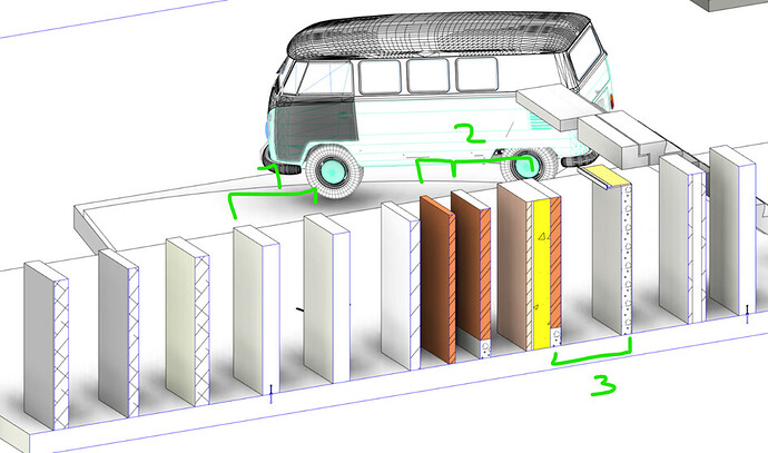

Hi @kvcXCAA8 Kasper,
Not a straight answer to your questions, but you can always consider to leave the schedules and the need to manage a large number of Family types.
If you create parts, you can get your description from the material, or from a combination of
-type (wall),
-Material(insulation) and
-instance (width) characteristics.
So you have a maximum benefit of the modelling environment, have Dynamo synthesize the codes, and find the result in Assemble or Power BI.
Coding can be done on Materials, elements, or a combination of both.
