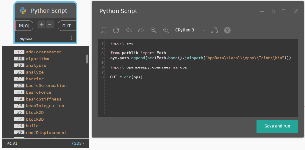

Opensees loading in Dynamo Sandbox
import sys
from pathlib import Path
sys.path.append(str(Path.home().joinpath("AppData\\Local\\Apps\\Tcl86\\bin")))
import openseespy.opensees as ops
OUT = dir(ops)
