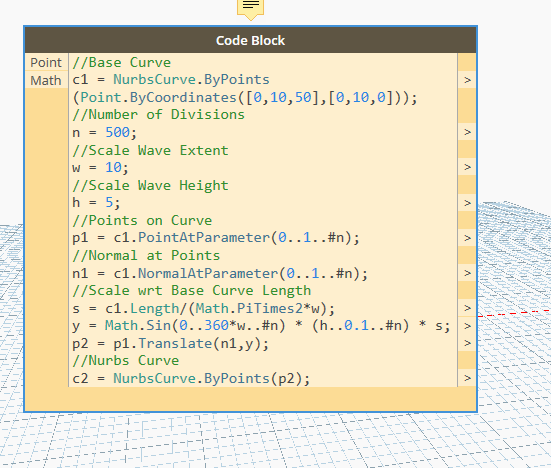

Hi all,
I trying to get the number in front of the code block like image 01 , but when i copy the code into the code block is it shown like image 02 , can anyone point me to the correct direction , thank you in advance
Hi all,
I think , Its in Revit 2022 Dynamo
Code block are updated and by default you will get those number.
Hi Jain,
I tested in revit 2022 , it work, but the script done by @Vikram_Subbaiah was in 2020 (in screenshot below , is there any method to do it in Revit 2020 ?
Sorry Bro.
Its Dynamo 2.6 version
ya, i checked on Dynamo 2.3.1 , it doesn’t have the setting…
Hi @ck_BA
He has used DynamoCore 2.10 not Dynamo4Revit which can be found in https://dynamobuilds.com/
Thank you all, i will try to install the DynamoCore2.10
