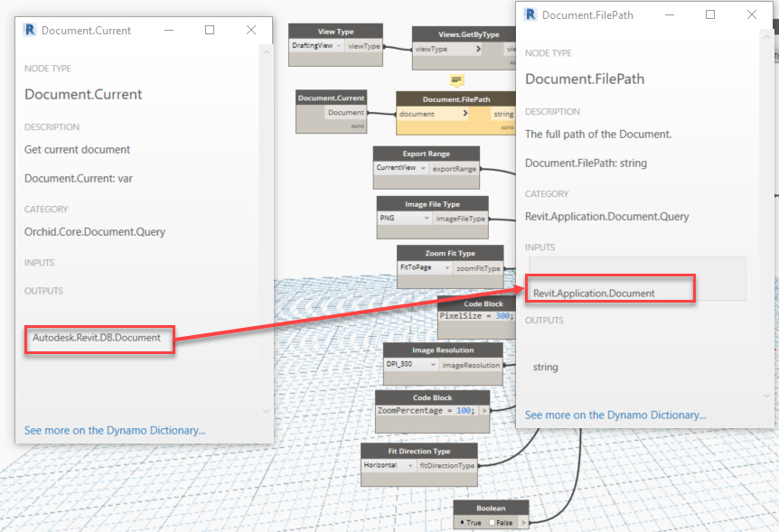

I was trying to follow the above to get the File Path, but get an error trying to tell Document.FilePath the Current Document. Any suggestions? Thank you in advance!
#11
Try to the OOTB node Document.Current you are using the Node from Orchid Package
And what is the warning?
