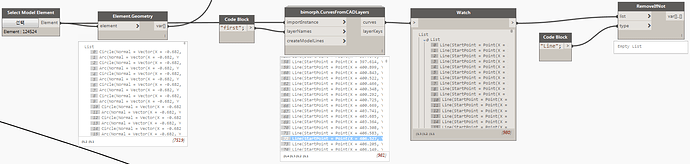

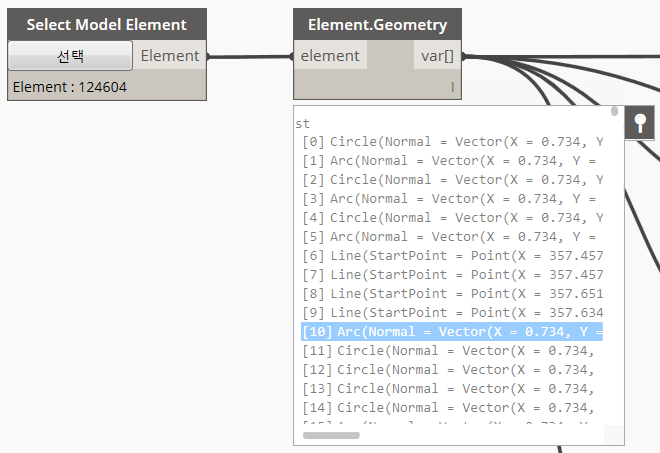

I’d like to filter the line in geometry but i have a lot of data circle, arc and lines in list.
how to fiter the line only?

I have tried to like as you, but my node doesn’t read “Line” code block.
Is there any problem in my node?
Line not line
@dreaminglisa3 Change the lacing to Longest on RemoveIfNot
It works fine!! Thank you for your help.
