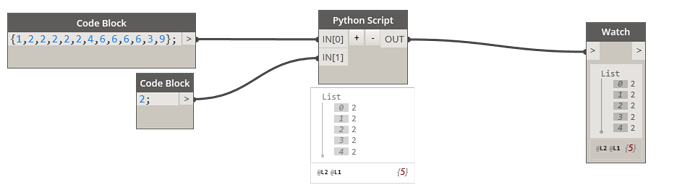

I have numbers, i would like to filter them for example all my “6” numbers or “2” numbers, in my watch block,
is here the for-loop usefull?
I have realy no clue, thank you for any advice

Hi @Draxl_Andreas ,
I’m not sure I understood properly.
You can do it with dynamo nodes without python.
items = IN[0]
filter = IN[1]
numbers = []
for i in items:
if filter == i:
numbers.append(i)
else:
continue
OUT = numbers
Or the node method:
An == node, and a List.FilterByBoolMask node.
Or a code block method:
List.Clean( item == target? item: null, false);
