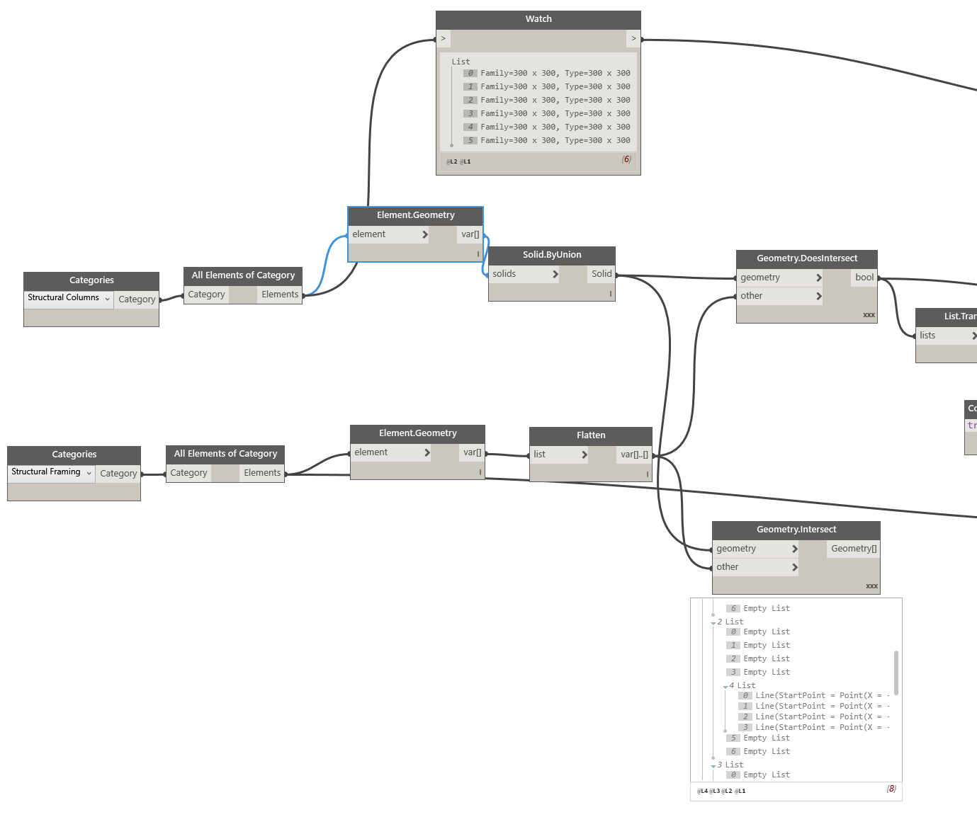

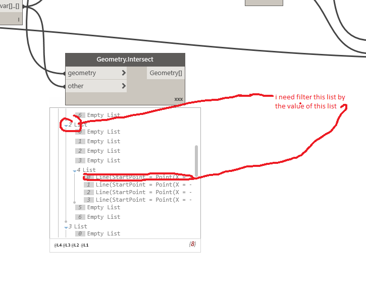

I have a problem. I need to filter the list by the key of the nested list of nested list as below
Please help me the value of nested list can change from line to solid

Thank all for your reply, my ideal is want to check the clash of element and want to filter the element which clash with other elements. And i want to filter the intersect geometry is line or solid. Please see the graph below.

The first i check the clash between columns and beams and override colour of column and beam which clash with other.
But the intersection of column and beam may be solid or line so i want to override colour base on type of the intersect. This part is where i have problem.
This is my file:Check Clash-V1.dyn (18.9 KB)
