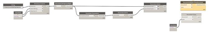

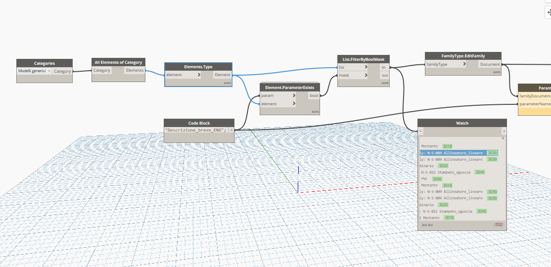

I’m trying to delete a family parameter in a project and I make this script. I select “Generic Model” as categories, and choose what family contains parameter. When I run the script the “Delete node” don’t run and delete the parameter from 1/2 element of list.
How can I risolve it?

I also tried mentioned script however, could not able to reach proper result. The script delete some of parameter but some not (Type and Instance Parameters).
What can be reason for that?

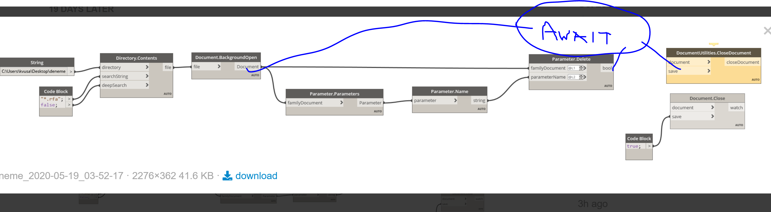

At the Parameter.Delete node output is bool at my computer. However it is Document at your screenshot. That is why i could not managed to realize your solution.
Can you please assist.:
