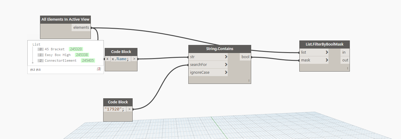

Thank you @Draxl_Andreas, I have created a Lighting fixture family with many nested families inside. When i tried to run your Dynamo model, In the ‘Element in Active view’ node doesn’t show the family types. It shows only the nested families presented. I wanted to delete all the family types except 5 families in the Lighting fixtures family. I could not find the ‘Elements.Delete’ node too.

Yes the families are shared and i can see them, But i cannot see the Main family, Nested families inside the lighting fixture is shown but not the Family types of the lighting fixture.

But when i did your Dynamo script, I can see only the nested families as below
