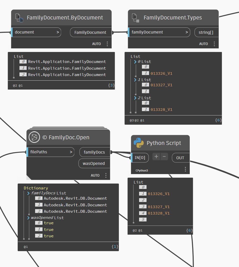

Previously I ran a Dynamo Script which added and filled Parameters to those families (background opened). Most of those families already had a type, (but some had no Type at all). Within the Families without a Type it seems that this “Dummy” Type was created. Later on real Types were applied to the Revit Families (without Types) manually, but the “Dummy” Type seems to be still existing in Dynamo/Revit API. The weird thing ist: mostly those Dummy Types are not visible in Revit, but rarely a Family seems to have no Type, but with clickling on the dropdown Menu in Revit, die real Type can be found (occurs only within the Family Editor - in Revit Projects, only the real Type is visible)
Is there a way to delete/purge such Dummy Types with Dynamo / Python? In the Screenshot I added what Dynamo sees for DB or Family Documents and the existing Types per Document.

Thanks! - Not quite sure yet, I’m trying to get the ID out but seem to only get an Empty List. I created a Python Script to read out all type names, the current type (which is the correct one) und die IDs.
I added the Python script as well. (Still working on it..) :upside_down_face:

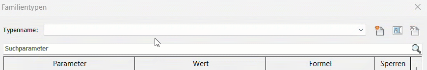

In most cases it seems to make no difference in Revit, but for a few is looks like that, which just seems weird:
123
I noticed that it was blank before you selected the ‘true’ name.
Can you rename the blank selection if you restart?
No I can only create a new type, but if I change any Parameter value in the blank Type and then create a new one, the new one has the same values as the blank Type (not the real Type) and the blank Type is gone.
