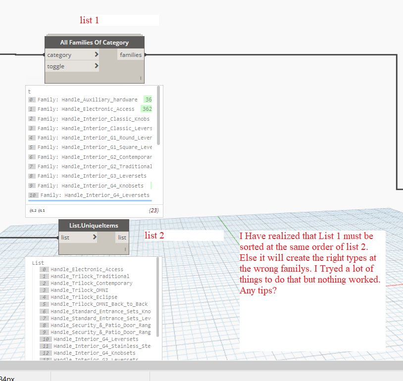

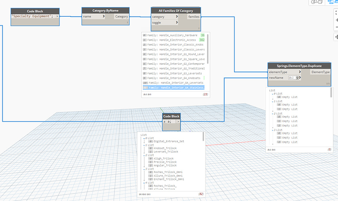

Create and delete family types for revit familys in a folder

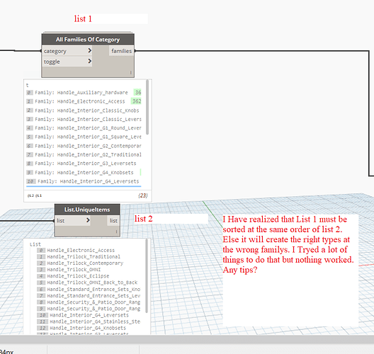

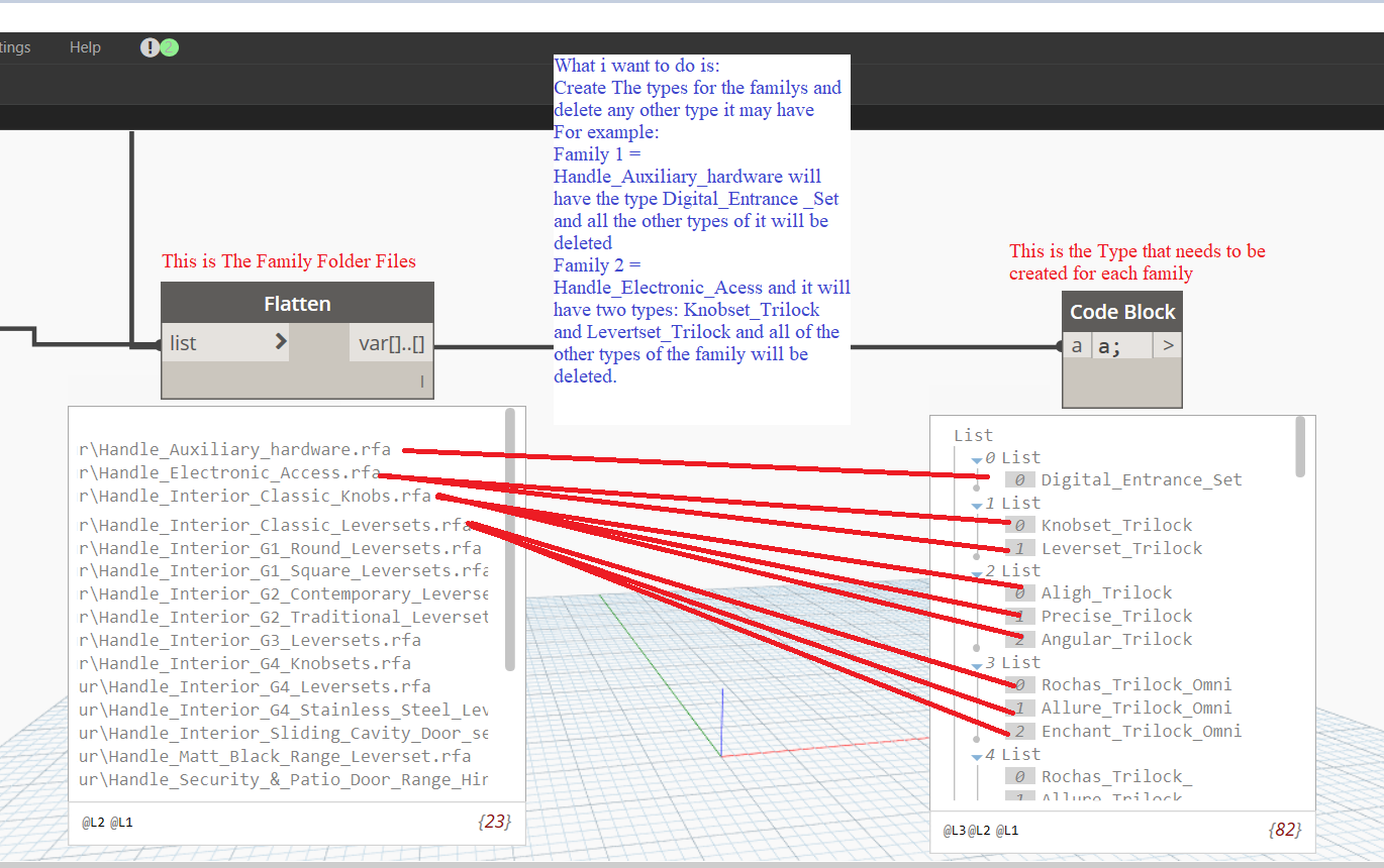

So i have to create several types for several different familys
i’ll better explain it in the attached picture.
I would be glad if anybody could help me on this one

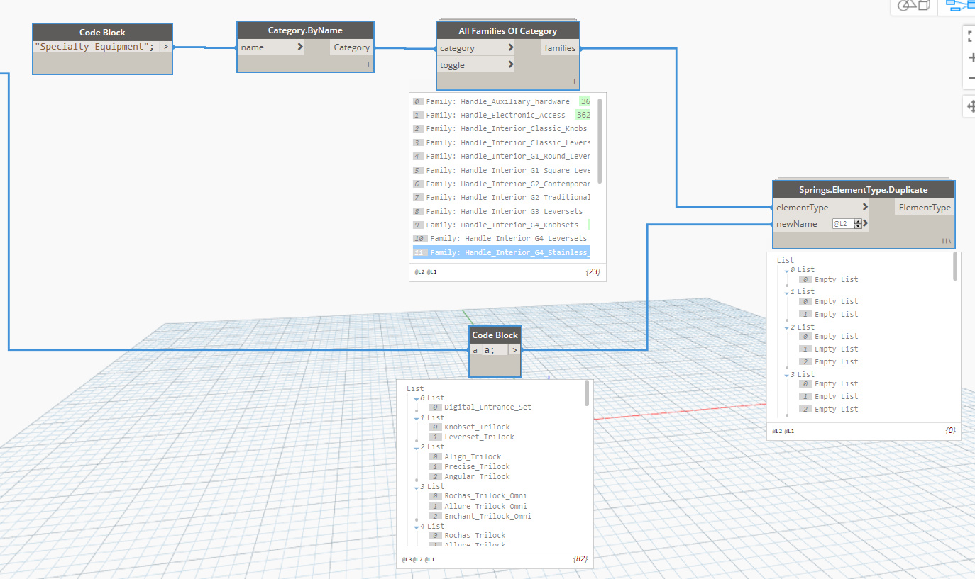

Managed to do this. But it is returning me empty lists…
I would still need to delete the existing types

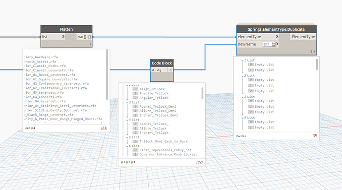

Unfortunetely i don’t know anything about python… so i guess i’ll have to load the families into a project. Create the types from there and then use that method you thought me before to export those familys
So i did that… and it still didn’t work… Any ideas?

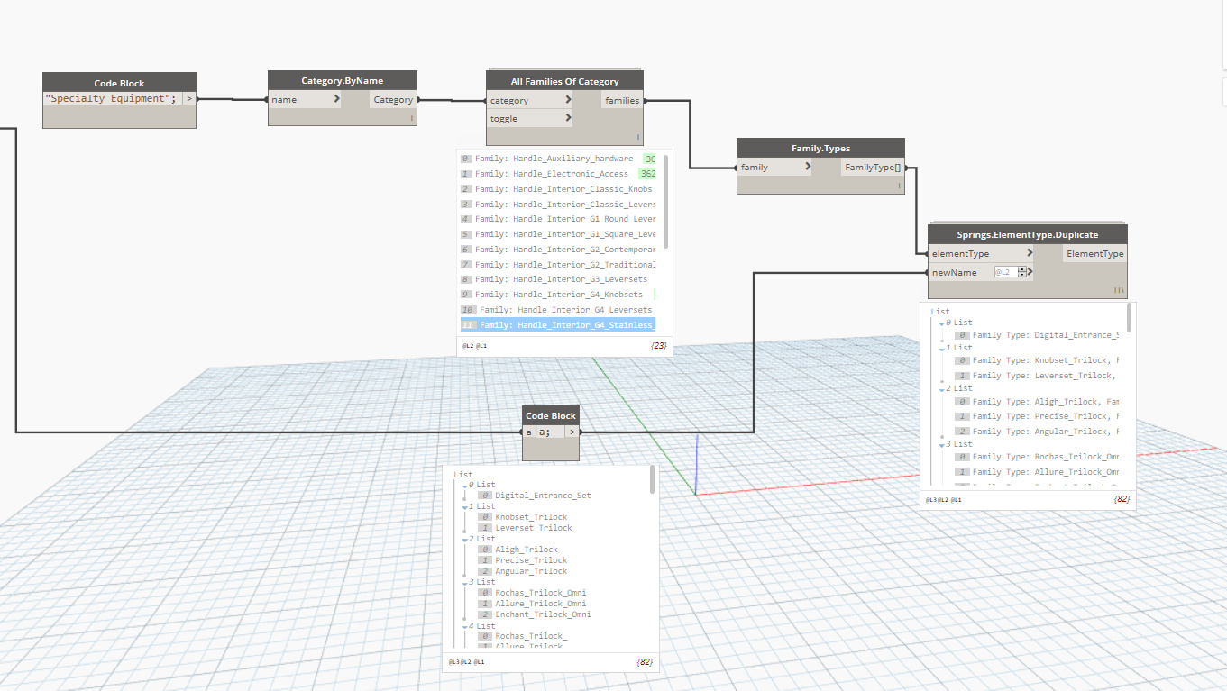

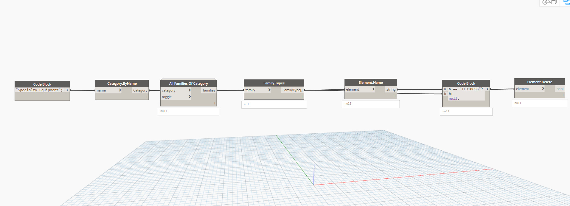

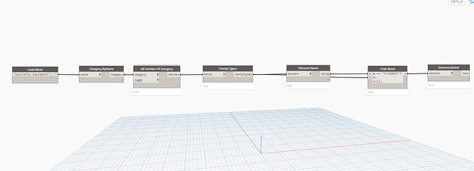

Managed to do that. But how do i delete a family type?
Since all the familys are a copy from one family. they all have one type in common. I need to mass delete it.
Thanks for your help!

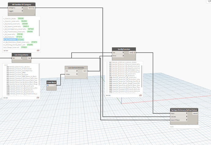

I realized i was doing a mistake… Could you help me ?
Tryed to do that through Dicionary function but it didn’t work
Relaunched Dynamo and that worked. Now i’ll try what you suggested @erfajo
Found the solution.
Here it is

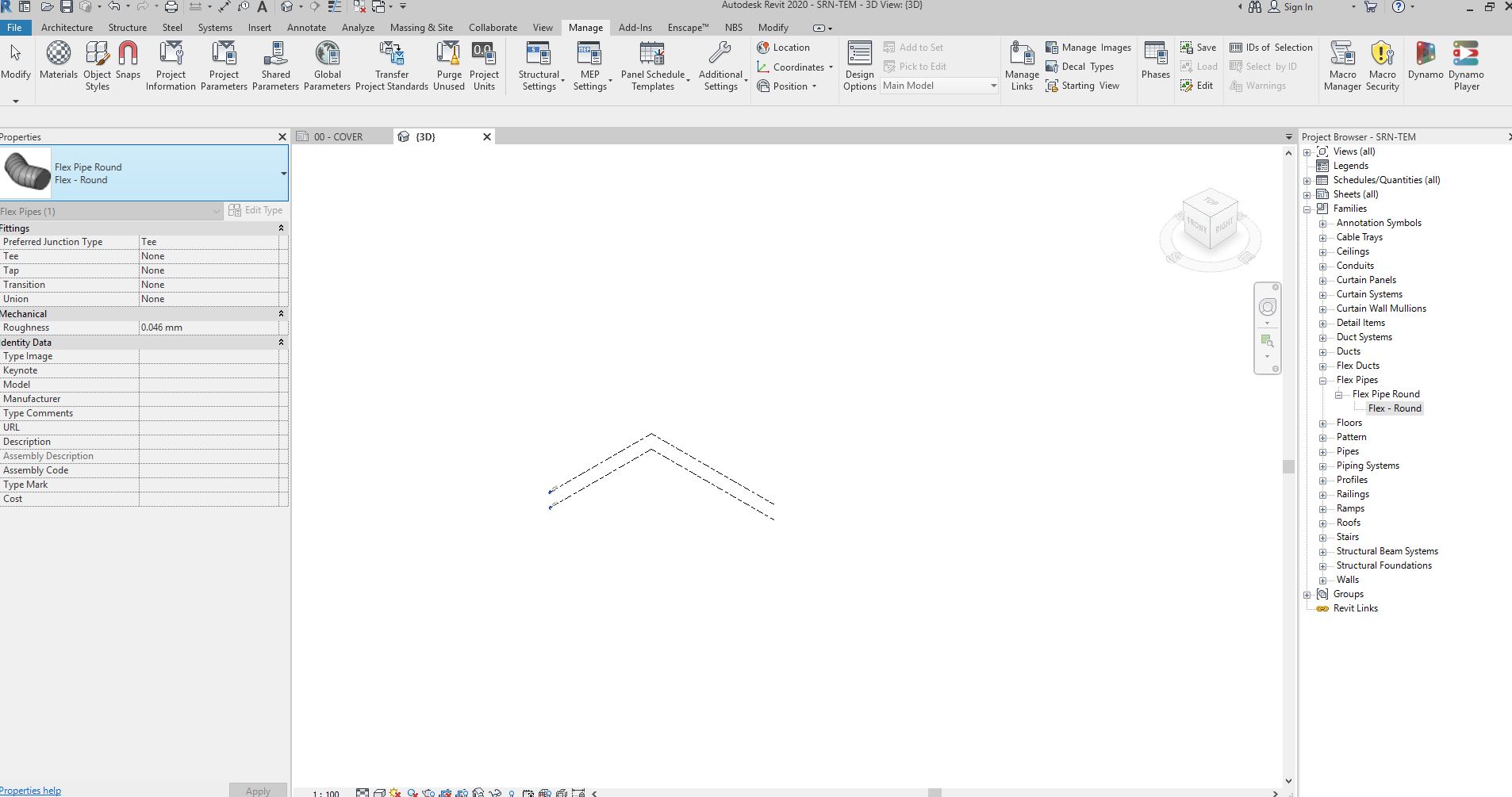

I want to delete some families ( Mechanical and electrical ones) that i am not using ,
I just realized i can’t do them by right click and delet.
Any idea …
I also have dynamo but never used it thorough Revit ?
