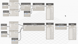

I did, but only found how to apply a function but not how to compose it.
Andreas,
The Dynamo Language Guide does not explain how to compose a function. I want to know how to compose a function, not how to create it.
You didn’t explain your question very well in the initial post.
The “Function.Compose” node doesn’t have a direct equivalent in a code block, because you can simply wrap functions inside other functions:

Dimitar, your image has no link to a larger version.
