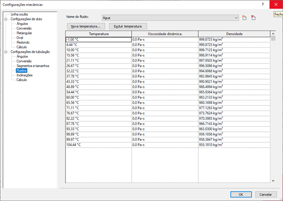

How to collect the values Fluid from the attached image
Where is that from?

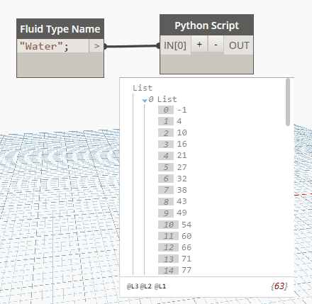

this should get you started, do necessary conversion
import sys
import RevitServices
clr.AddReference("RevitAPI")
import Autodesk
from Autodesk.Revit.DB.Plumbing import *
import Revit
dataEnteringNode = IN
fluidName = IN[0]
_temperatures = []
_viscosity = []
_density = []
# Place your code below this line
FluidTYpe = FluidType.GetFluidType(doc, fluidName)
elemItr = FluidTYpe.GetFluidTemperatureSetIterator()
elemItr.Reset()
while elemItr.MoveNext():
	temperature = elemItr.Current
	temp = temperature.Temperature
	deg = UnitUtils.ConvertFromInternalUnits(temp, DisplayUnitType.DUT_CELSIUS)
	viscosity = temperature.Viscosity
	density = temperature.Density
	_viscosity.append(viscosity)
	_density.append(density)
	_temperatures.append(deg)
#MessageBox.Show(fluidName)
OUT = _temperatures, _viscosity, _density
