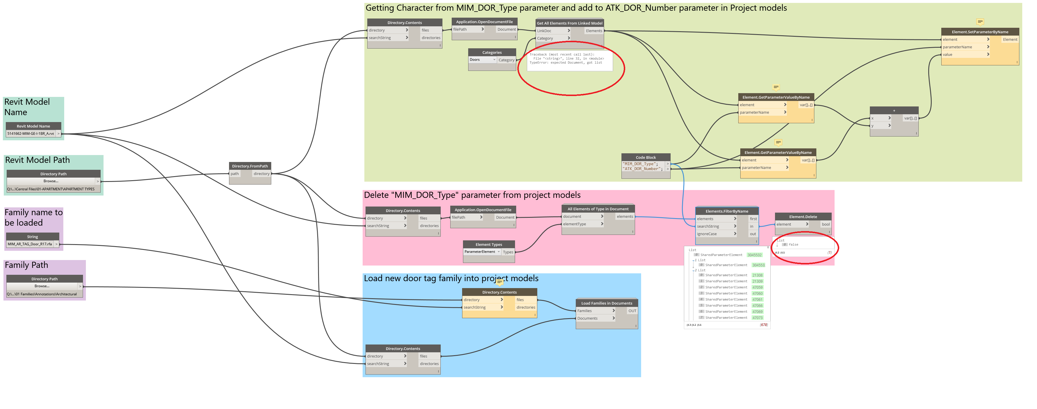

How to apply a certain actions to UN-opened Revit Models
Dear All
I’m trying to apply these actions to multiple revit models at once
Any Ideas ??
The dynamo code hereunder
Apply Actions to un-opened revit models.dyn (12.5 KB)

thanks a lot but how could i link the above actions nodes to the models opened in background nodes
Did you really try with the graph I provided above ?
I do not normally do the work of others.
P.S : You maybe need to adjust levels and lacing on nodes. I didn’t try your graph.

yes i tried the graph you provided in your first posting but my problem was how to link between opened model an the action i need to perform.
I don’t like from others to do my work , i just shared the pictures and the dynamo code to clarify the issue i need to solve
thanks again Alban_de_Chasteigner and apologize for any conflicts

You didn’t reproduce the “levels” in the nodes like in my picture.
still have the same issue :disappointed_relieved:

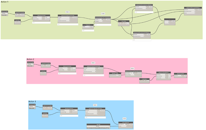

You can’t keep the 3 “actions” on the same graph or you need to use some passthrough nodes.
You have to wait until I update my package. (“SetParameterByName in document” node)

Don’t forget to divide into 3 parts your graph.
if i won’t to divide the graph, is the pass through node will help or not??
the problem is with the delete parameter part. If you delete the DOR_Number parameter at the same time that you set values, it can not work.
The parameter deletion part must be performed after action 1.

i have tried this dynamo code with 3 actions without dividing them on a current document and it is working nice without any problem
